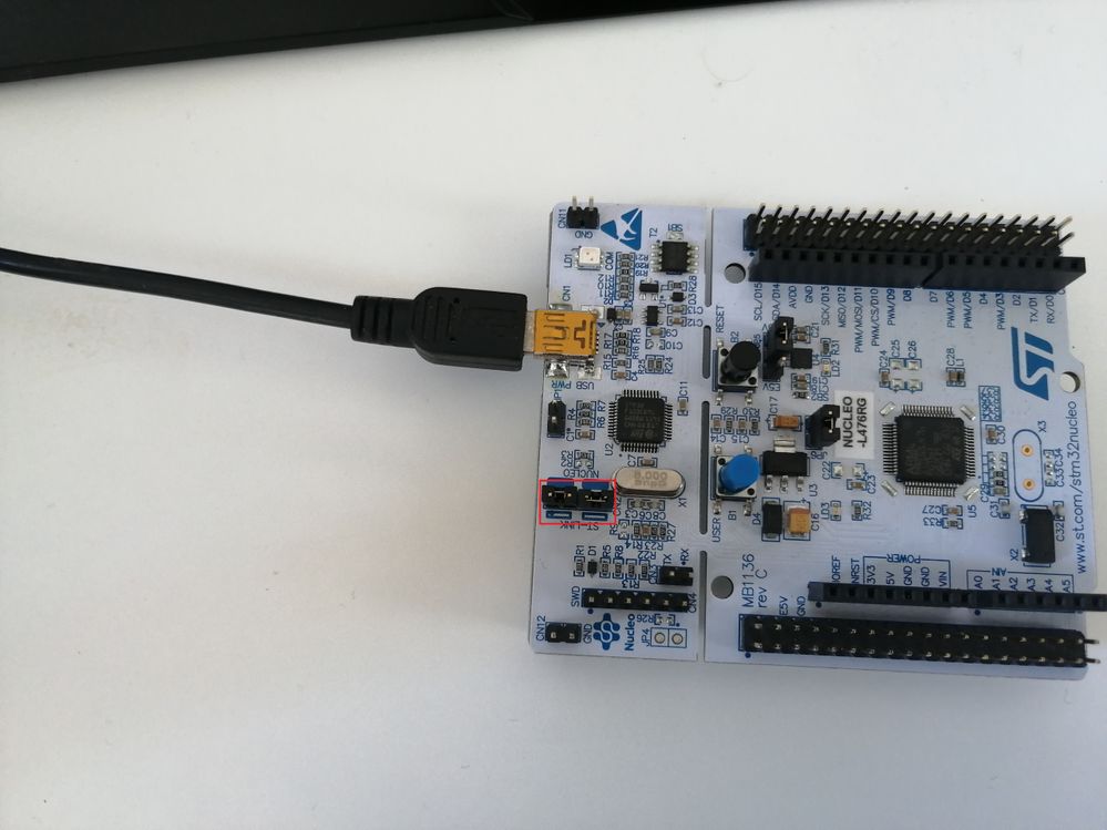

2020-09-15 11:17 PM
How do you connect the Nucleo to PC, physically? Post photo.
2020-09-16 1:40 AM
I use the usb connector to connect it to my pc. I tryed to remove the jumper (in the red square) to select the nucleo as it is said in the schematic (sheet 3).
2020-09-16 3:16 PM
You need to connect PC to the USB pins of the target STM32L476, see its datasheet and the Nucleo's User Manual for pins location.
Now you are connecting to the STLink.
2020-09-17 1:00 AM
I agree, this is why I remove the jumpers in the red square. It is said in the schematic that they are connected for St link mode.
Edit :
I just notice that I did not read well the schematic, I will try again.
