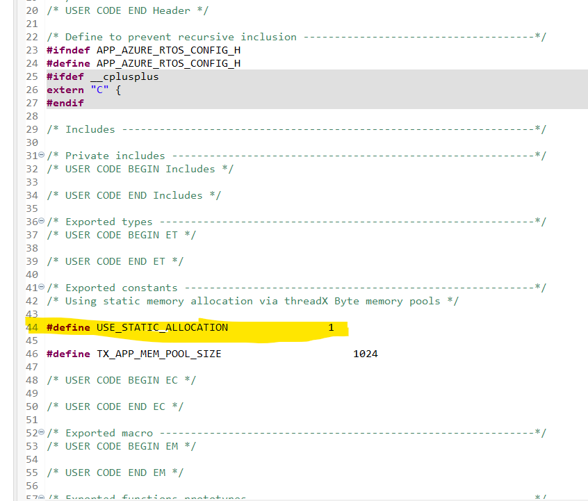

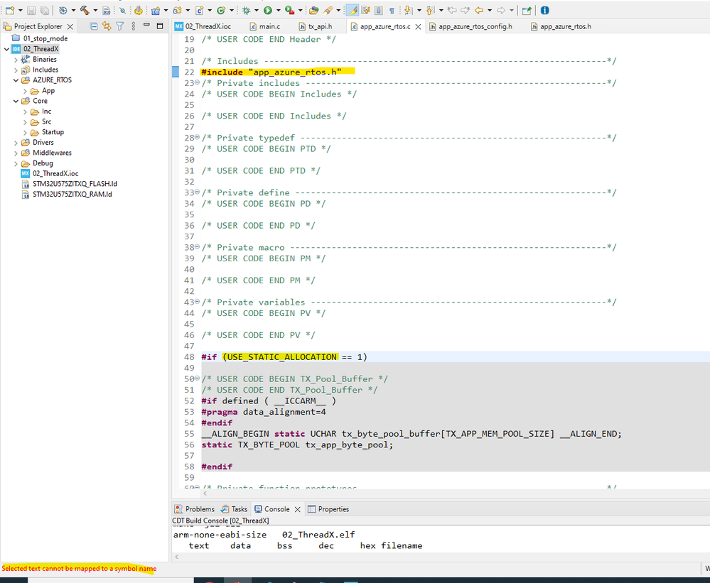

Despite the USE_STATIC_ALLOCATION is defined to 1, code is showed in gray, I added a break point on gray section and stoped well.
Down below the sequence to found the path to marco definition:

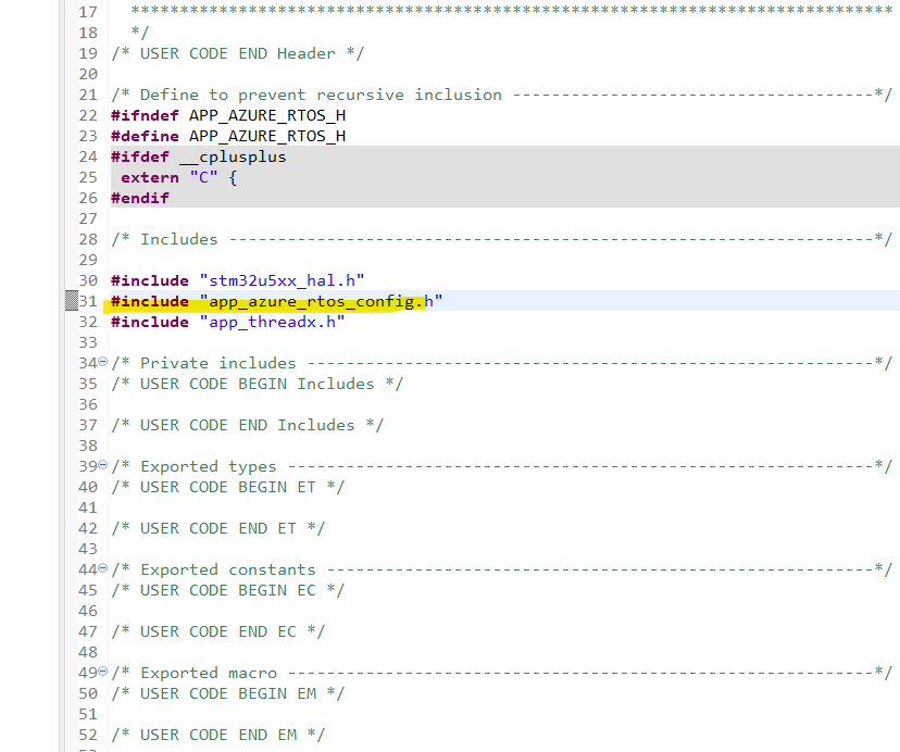

app_azure_rtos.c include app_azure_rtos.h this include app_azure_rtos_config.h this one has the sentence : #define USE_STATIC_ALLOCATION 1

I have the same problem when I try to make a project based on STM32U5 evaluation board and enabling the ThreadX middleware.
Is this a bug ?
2024-10-29 2:36 AM
this problem now occurs very often. I don't know why Eclipse could not see definitions in nested include files.
Now I am using STM32Cube Version: 1.14.1, Eclipse 11.3.0.x
Rebuilding or refreshing index files did never helped me.
What I have found - only solution which helped me, is to delete project from workspace (without deleting files on disc of course) and then import once again. But if you need to do it 2 or 3 times per hour it is not good solution...
Does anybody have some better solution ?
