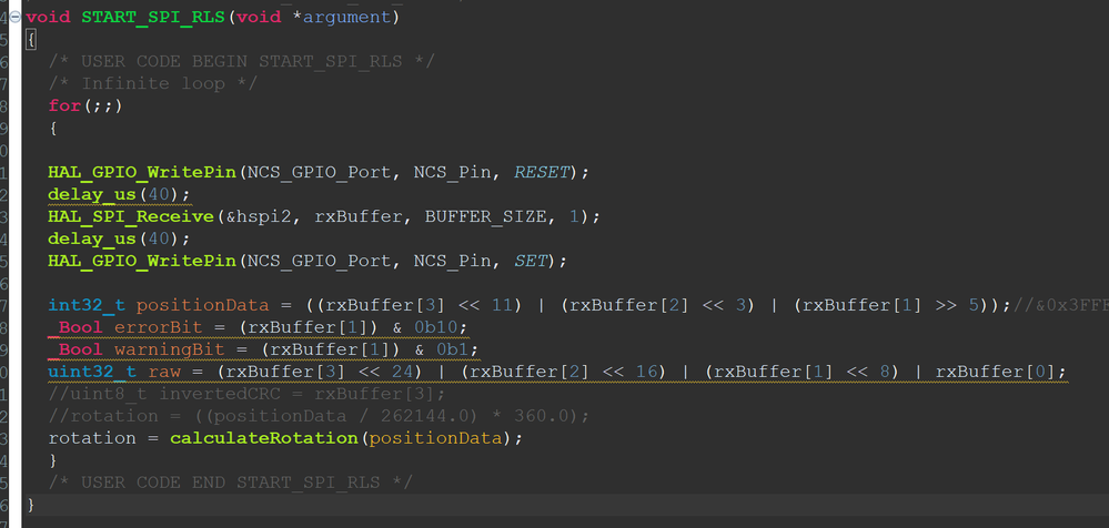

I need 40 us delay. I made my own function using timers, which works on NUCLEO, just using it in main. Now that I put my program my circuit, I moved that SPI part on freertos, but now I have problem, because that delay doesnt work anymore. I would use osDelay, but that is only ms and I need us. Why my delay using timers doesnt work and is there any other way to make it. Thank you for help.

Have exactly same issue when need precise timing in us for SPI communications in RTOS (STM32H743 + HAL).
have this timDelay_us function in timer 1 but still cant get it working.
void timDelay_us(uint16_t us){
uint16_t entryPoint = __HAL_TIM_GET_COUNTER(&htim1);
//__HAL_TIM_SET_COUNTER(&htim1,0); // set the counter value a 0
while ((uint16_t)__HAL_TIM_GET_COUNTER(&htim1) < (us + entryPoint));
