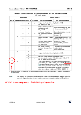

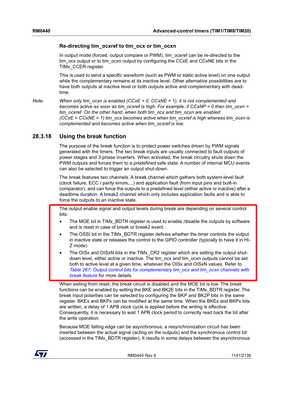

For exact behaviour of BREAK functionality, read the Using the break function subchapter of TIM1 chapter in RM. There are several options what can happen, depending on setting of several bits:
This all only if you indeed have selected the output of comparator to trigger a BREAK (i.e. the respective TIMx_AF1.BKCMPxE set and TIMx_BDTR.BKE set), rather than using the comparator as OCREF_CLR source (as selected by TIMx_AF2.OCRSEL and enabled by TIMx_CCMRx.OCxCE).
