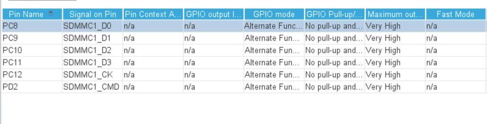

I saw on other post on the same topic that some people have a sdmmc.c file generated but I don't have it, thus I don't know where the SDMMC1 gpio are set.
According to CubeMx my Gpios are set like it :
SDMMC1 clock is set to 48 MHz.

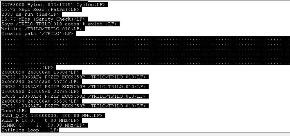

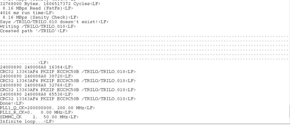

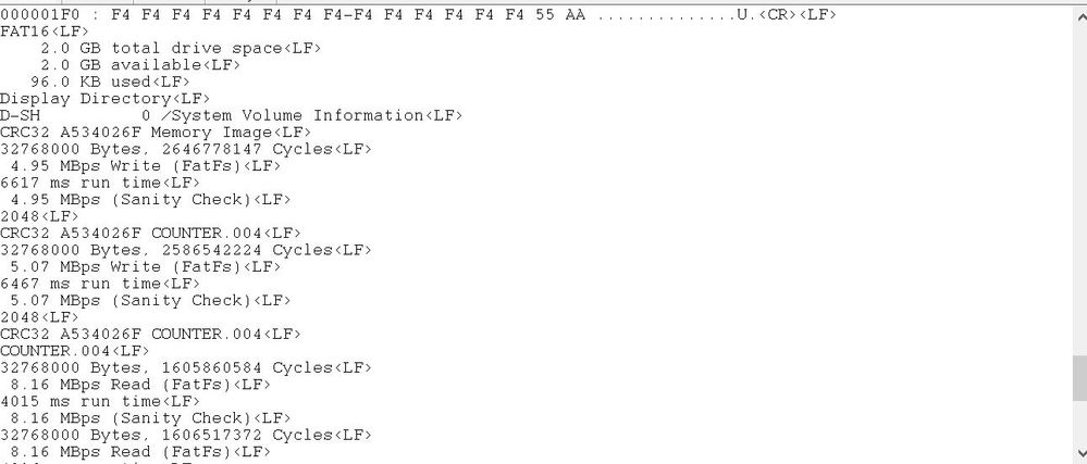

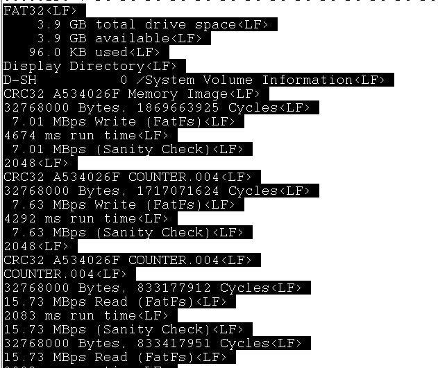

I don't find SB117, SB116 on my board (I higher SB that I see is SB82), if you were talking about SB17/SB16, there are no resistors on these SB. I use your hex file to understand what happens on 2 different µSD ( 2Gb which was working in 1 bit mode before and SDHC 4Gb class 10 which was not working before because of dataTimeout error during th SendStatus() function).
On the photo the 4Go µSD seems to work with your hex file ( in highlighted in black ). Thus I really don't understand why it is not working with Cube.When I try with the 2Gb card it works too :
How did you configure your SDMMC peripheral ? What software do you use to program your card ?
