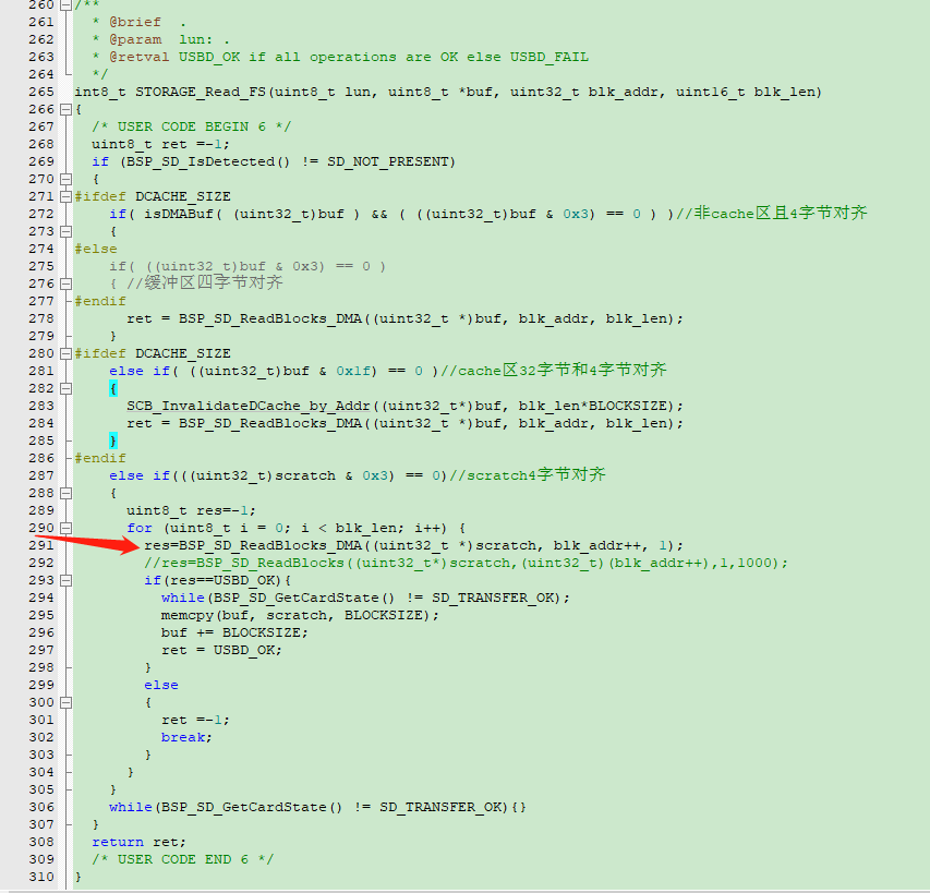

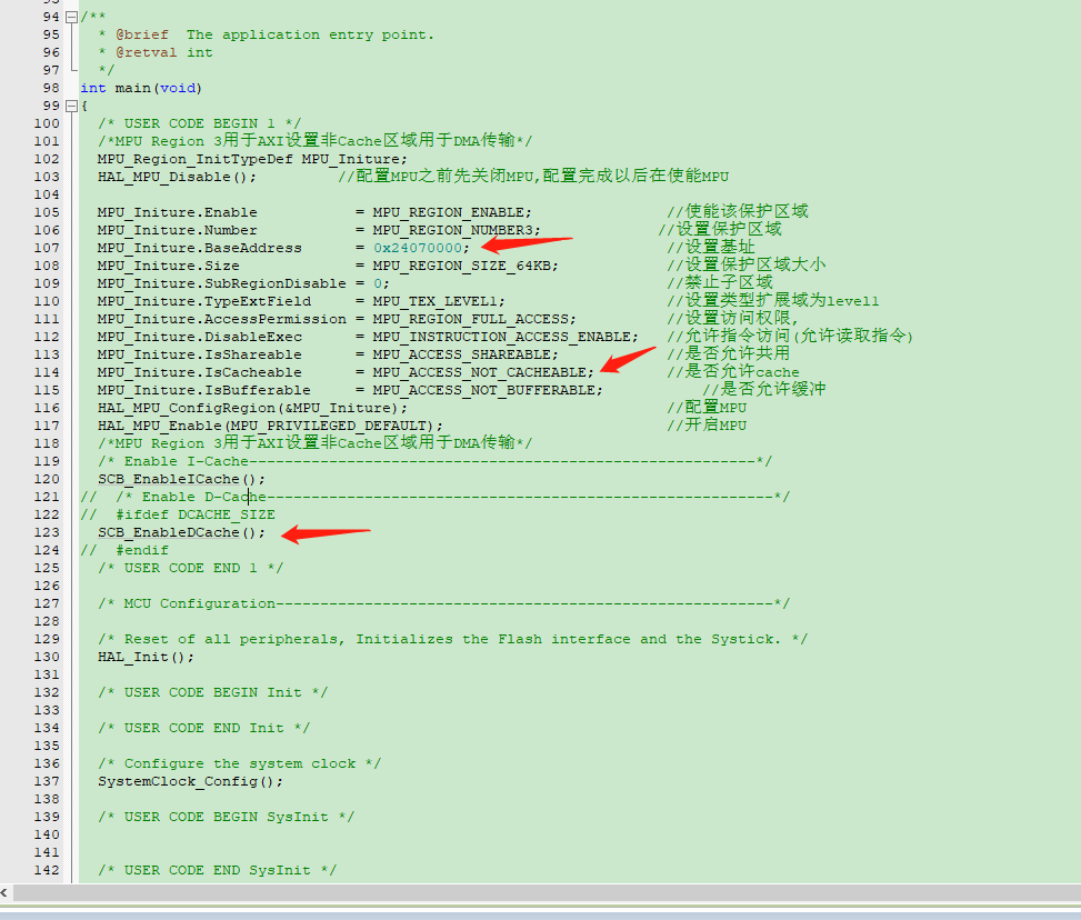

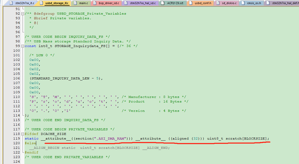

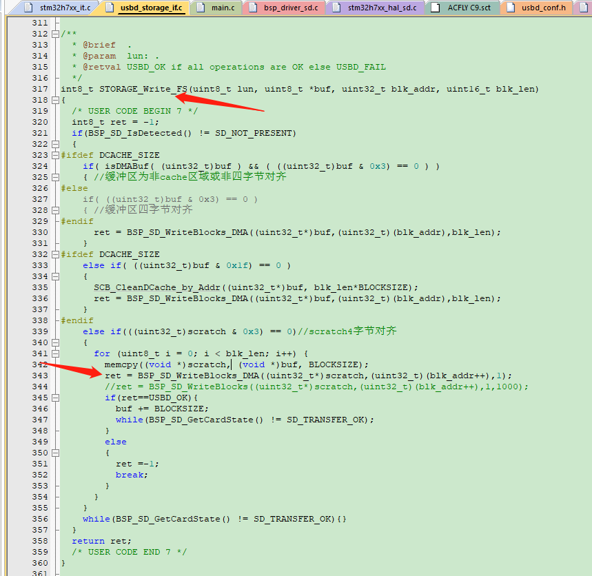

project: USB_Device MSC using sd card
stm32h743,cubemx5.6.1,HAL Driver version 1.8.0
1 only using BSP_SD_ReadBlocks() the project is working,but is to slow
2 using BSP_SD_ReadBlocks_DMA() is not working ,can not enter SDMMC interrupt
3 open Dcache is not working
I have took cahe and anlign and AXI RAM into consideration,it still not working.
Is it a bug??? Please help!!!
