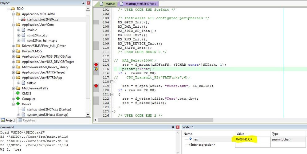

2021-01-01 12:03 PM
I ported the code to 32F407VE by changing only the startup file in KEIL MDK (i changed also the device type) Both devices have the same pinout for SDIO)
The result was as expected. The SD 16GB sandisk, 8k cluster formated, mounted with no error.
Maybe is a hardware issue, pinouts, bad soldering, etc

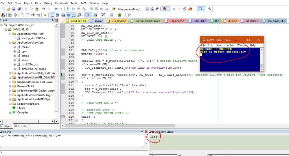

2021-01-02 12:28 PM
Hello
I can read an write to 16GB sandisk sd card. (look at the screenshot). FATFS ver=R0.12C Check the format of SD card or reformat it( usualy this solves most problems)
As for the DMA, i forgot to enable the dma version of diskio. But works fin if enabled also.
