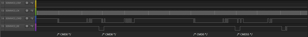

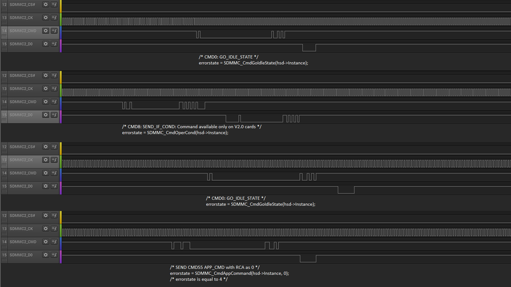

I think one of the biggest areas of confusion for me is the output of the SD-card in my setup under two scenarios: running and step-by-step debugging; the former appears to be truncating the output of the card while the latter shows the full response - please see images attached:
Normal running....
Step-by-step debugging....
