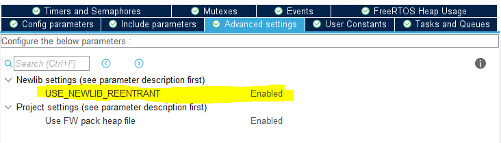

While re generating through Cube MX for MDKARM make sure USE_NEWLIB_REENTRANT should be disabled in the advance settings of FreeRTOS.

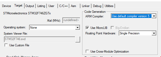

in the Keil IDE you must select ARM Compiler version 5 ... if it is not installed you must intalled it.

I already followed these steps in order to generate the project files for uVision. This is how I found out the code diffs.
I know that I can generate and use different lwipopts.h and FreeRTOSConfig.h files for each toolchain but I'd prefer to generate and use the same files for both toolchains. Therefore I use compiler directives in config files.
