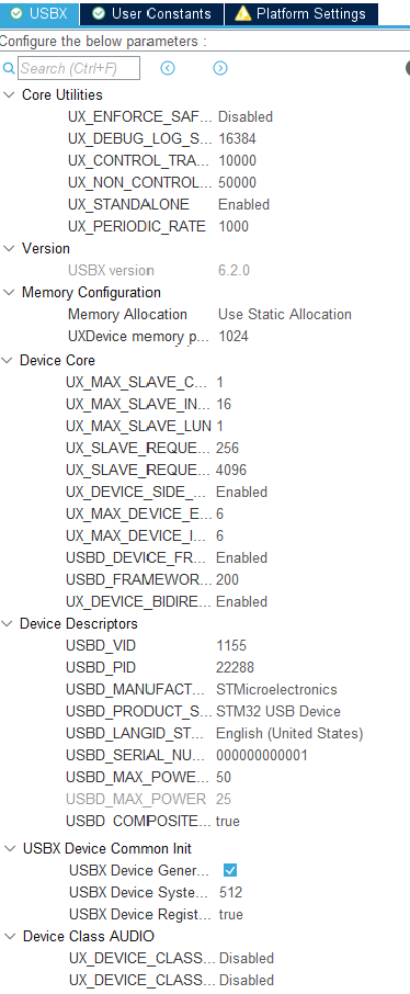

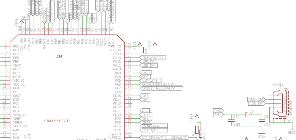

I'm creating a custom board using a used STM32H563VIT. Nice processor, but I can't understand how to create an Audo class, even if it's BT 1.0.
In the F series of processors, e.g. STM32F720, it was simple, but here it is somehow mixed up.
USB parts diagram:
I am trying to use a USB Adio class device.
For this reason, there is no AZURE RTOS in the IDE (H5).

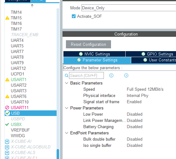

I have configured the USB
I configured USBX as FS_Device
I took the stack size
After my changes
The device is in working order HAL_PCD_STATE_READY

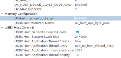

i made Audio host , with Azure/threadx, so its not same, but :
- i needed a lot more memory, to get it work -> so try more memory

static void MX_USB_PCD_Init(void)
/* USER CODE BEGIN USB_Init 0 */
/* USER CODE END USB_Init 0 */
/* USER CODE BEGIN USB_Init 1 */
/* USER CODE END USB_Init 1 */
hpcd_USB_DRD_FS.Instance = USB_DRD_FS;
hpcd_USB_DRD_FS.Init.dev_endpoints = 8;
hpcd_USB_DRD_FS.Init.speed = USBD_FS_SPEED;
hpcd_USB_DRD_FS.Init.phy_itface = PCD_PHY_EMBEDDED;
hpcd_USB_DRD_FS.Init.Sof_enable = DISABLE;
hpcd_USB_DRD_FS.Init.low_power_enable = DISABLE;
hpcd_USB_DRD_FS.Init.lpm_enable = DISABLE;
hpcd_USB_DRD_FS.Init.battery_charging_enable = DISABLE;
hpcd_USB_DRD_FS.Init.vbus_sensing_enable = DISABLE;
hpcd_USB_DRD_FS.Init.bulk_doublebuffer_enable = DISABLE;
hpcd_USB_DRD_FS.Init.iso_singlebuffer_enable = DISABLE;
if (HAL_PCD_Init(&hpcd_USB_DRD_FS) != HAL_OK)
Error_Handler();
/* USER CODE BEGIN USB_Init 2 */
/* USER CODE END USB_Init 2 */

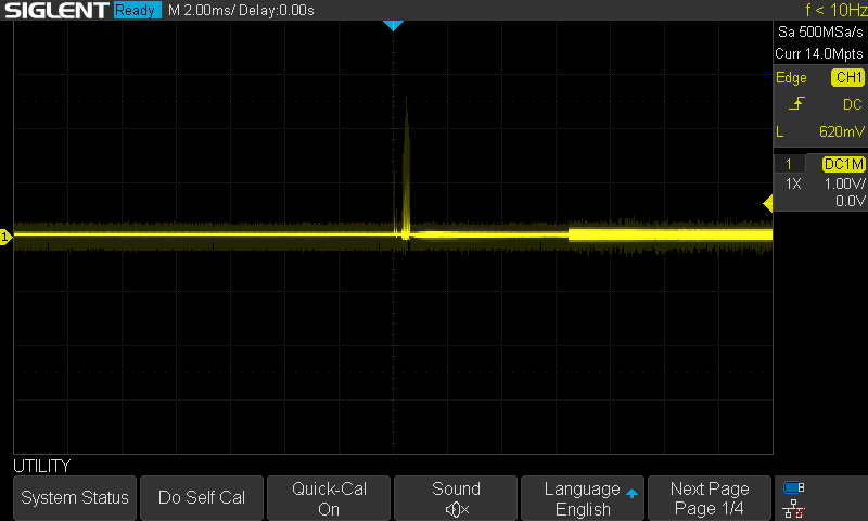

2024-05-13 10:41 AM - edited 2024-05-13 11:22 AM
I checked with an oscilloscope, no signal on DP.
I only see power disturbances
After soldering the 1K5 resistor to +3.3V, the system recognizes the device, but does not recognize it.
Now I have
The descriptor request failed
So its not powered or started .
