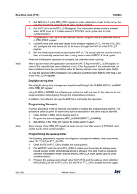

I've a project with the STM32G030F6 which use the RTC (SYSCLK=64MHz RTCCLK=32768Hz). During the setting of new date/time I enable the INIT mode with:
LL_RTC_EnableInitMode (RTC);
while (0u == READ_BIT (RTC->ICSR, RTC_ICSR_INITF))
The runtime of this while() loop is from 42µs to over 60µs. In the refernce manuel is descripe 61µs.
If the measured timing normal? An how can I reduce it?

Entering the INIT mode takes up to 2 RTCCLK cycles (probably between 1 and 2 RTCCLK cycles, depending on the exact moment when you set the INIT mode in code in respect to the actual RTC clock phase - the processor and RTC clock are mutually asynchronous).
If RTC clock is the usual 32.768kHz crystal, one RTC period is cca 30.5us, that where the cca 30-60us wait time comes from.
You can't.
Why is it a problem? Normally, RTC is set up only rarely, and then it keeps running from a backup battery, without need to go to INIT mode anymore (at least until the battery is exhausted, or until the user decides to change the time).

Thank for the answer, but that doesn't answer my question. The problem is the time to synchronise the RCTCLK with the MCU CLK during activation of the INIT mode of the RTC. After reference manual neet this 2x RTCCLK cycles. And that is to slow for my project.
I use at the moment the optimisation -O0, that is OK for me. I have change the __STATIC_INLINE to __STATIC_FORCEINLINE, so the optimisation is for this not used. And at the moment runs the complete main loop in the RAM, so I have the complete 64MHz performance.

@waclawek.jan I was afraid of it. My customer have start the develpment of the product without clarify the performance of the software. So I have a hard constraint, that after 80µs from receiving of a new date/time the application can make the next step. And at the moment the INIT mode need max. 61µs. So I have only 19µs for the rest and that is to short. So I've think a other peapple have an idee.
OK, thank for your answer.
You don't need to wait for the INIT state in a loop. For example, set the INIT bit in RTC, set up a timer to interrupt after a safe time elapses - say 65us - and proceed with setting up the RTC in that interrupt.

OK, that is not allowed in the application. So I will change the timing reqiurement and hpe that the project lead accept it.
