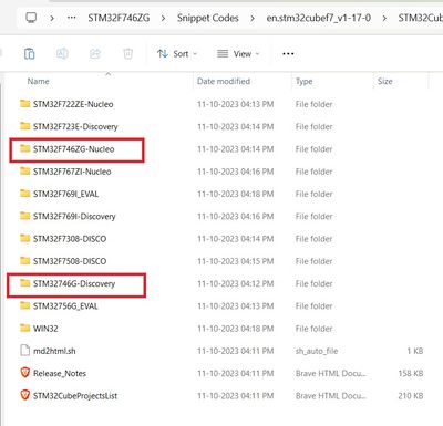

@mƎALLEmWhat is the difference between: STM32F746ZG-Nucleo vs STM32746G-Discovery? As I can see both of them present under the same snippet codes package?
And will the code base for Discovery work as it is for Nucleo?
Thanks,
Pluto
2024-02-27 2:09 AM
It's the same MCU (same die) with different package. If the SPI example works for the one it should work for the other.
The only thing you have to check: the GPIO pins and the clock configuration. So you need if necessary to make some changes according to the board schematics, pins exposed, etc.. but in final the example should work.
