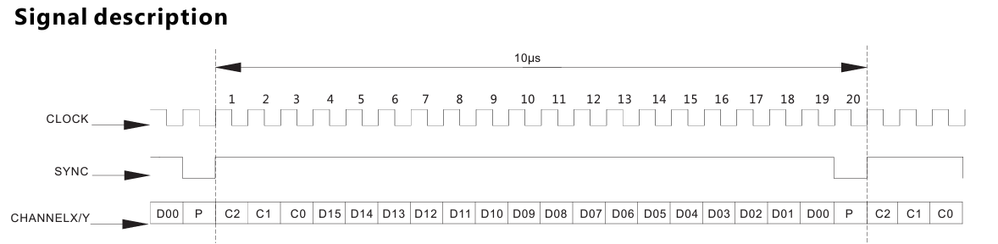

We want to develop a protocol called XY2-100. Here's a description of the protocol:
https://dvd.ilphotonics.com/Ray-Motion%20-%20galvanometers%20-%201D-2D-3D%20scanners/Motion%20Control%20-%20Optomechanics/Interface%20XY2-100.pdf
The protocol consists of four signals: Clock, ChannelX, ChannelY, Sync.

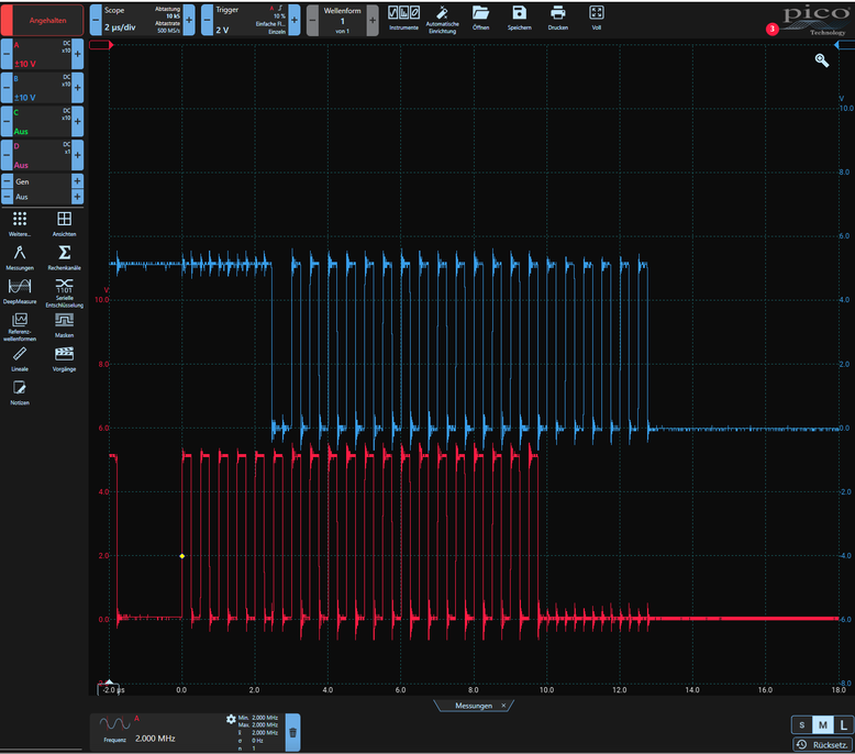

I observed these signals:: red TIM_CHANNEL_3; blue TIM_CHANNEL_4
The clock of 20 periods, which is what is stored in chx_buf, works perfectly and the channel_4 generates the same signals but it starts around 2ns later, which would be a problem.
