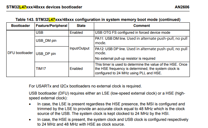

I advise you to refer to AN2606 related to STM32L47xxx devices bootloader and check the needed configuration.
