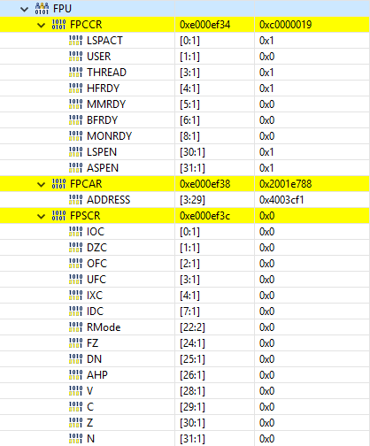

2019-06-14 2:10 AM
Here are some register values from the crashing point:
to us they seem to be quite normal - though our understanding on this area is not on very high (if any) level.
In our compiler settings the FPU is FPv5-SP-D16 and - as said before - the calculations are performed successfully and correctly until this crash occurs
