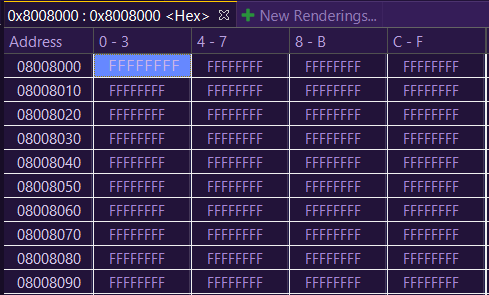

I am attaching the programmer console from the IDE. It looks like both .elf are programmed in the specified region but ultimately only the one that gets loaded last persists. Does this happen because during the download of the last .elf the whole FLASH gets erased? Is there a setting to prevent that?

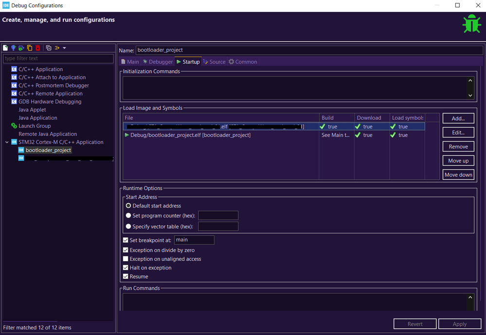

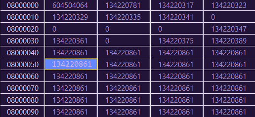

I have also attached screenshots of the memory regions and a screenshot of the debug configurations.
It might be useful to mention that if set the debug settings so that the start up is from the application, region 0x8008000 holds firmware and 0x8000000 is empty, which in my eyes enforces the hypothesis that flash gets wiped out before the second .elf is programmed.
Any thoughts?
Thank you!

Sector size is 128k bytes. Your bootloader and app must reside in different sectors, else an erase of the app will erase the bootloader too.

Try this:
build both projects, then load the application (don't debug or run).
Edit the launch config, uncheck build and download of the app. Only load its symbols.
Then start debugging the bootloader.

Yeah, this seems like the better approach for having a project you can quickly launch from the IDE and debug. Fortunately, in my case, I can spare the space.
I placed the bootloader in the same section of the app using the stm32 cube programmer as it presents an option to program without erasing, but this approach will not be convenient long-term for me.
