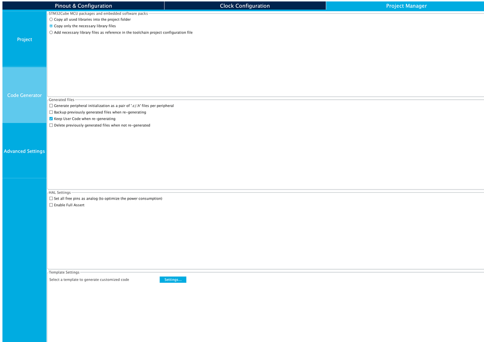

Try to uncheck in the Cube "delete previously generated files when not re-generated"
2023-02-21 7:21 PM
Thanks for trying but... same problem :(
results in...
