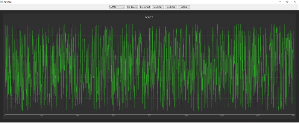

But, when i convert input data to integer value, the result was not square wave.
I sent data to desktop using uart. Below picture is result.

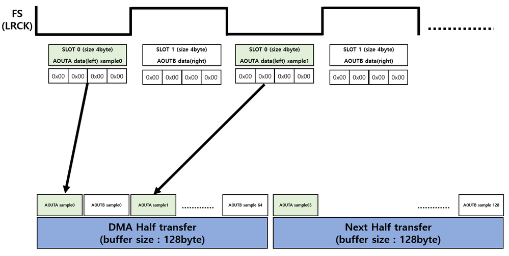

I think the dma and SAI buffer work as below.
Is it right?

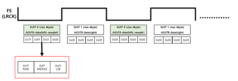

I convert 24bit data using below code.
def byte3_to_integer(value1, value2, value3):
d1 = value1 & 0x7F
d2 = value2 & 0xFF
d3 = value3 & 0xFF
result = (d1 << 16) + (d2 << 8) + d3
if (value1 & 0x80) == 0x80:
result -= 0x800000
return resultIs there anything wrong in the process of converting sample?
