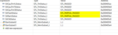

2023-09-08 2:06 AM - edited 2023-09-08 2:33 AM
Now class b running with threadx suessfully.
Why flash and RAM test status Partial passed?
My question STL_PARTIAL_PASSED status accept in certificate.
thank you.
2023-10-20 3:11 AM
status of your test is fully dependent on definitions of subsets at user structures and configured atomic steps. You can perform all the subsets at single run or per parts. Please study associated UG.
Best regards,
Petr
