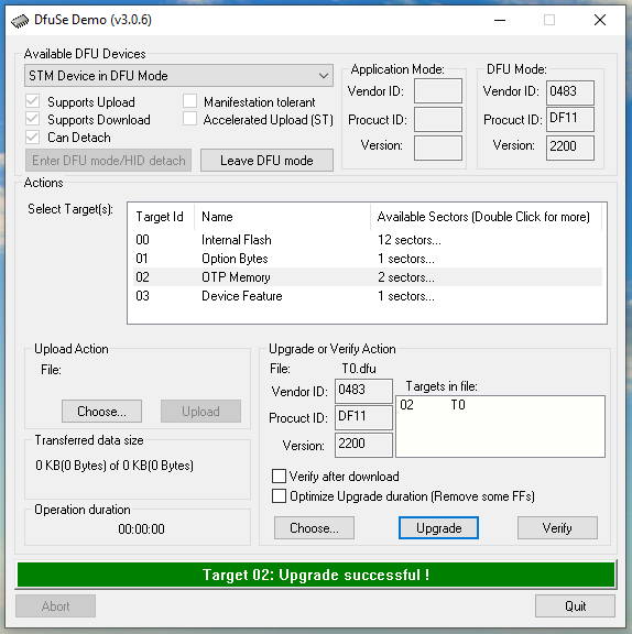

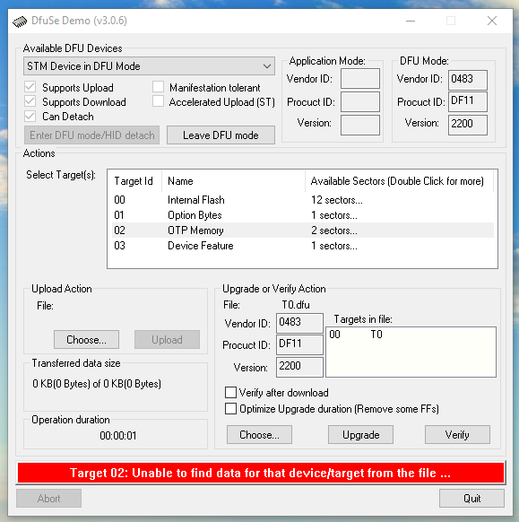

1) Issue is we are unable to upgrade new .dfu file in to a target board (which has STM32F767 ) with different target ID & different target name than already programmed in to our target board. (Please check image with red bottom line)
We can be able to load different .dfu files (generated using DFU File Manager (v3.0.6))which has same target ID & target name (Please check image with green bottom line)
We did full chip erase using STM32 ST-LINK Utility but still not able to reload different target ID in to target board. In which memory region these information regarding DFU (target ID & name etc..) gets stored, How can we erase or reprogram them?

2019-03-01 8:34 AM
>>1) Do we need to always select target ID value to 0 (zero) while generating a dfu file from hex file (object file/uC build) using DFU File Manager, Please confirm?
That's where your firmware is situated? Right? 0x08000000

2019-03-01 4:00 AM
Thanks for the reply.
2) We are using our custom VID/PID in CDC class inside firmware for our device, As we are going to use DfuSe utility for firmware update through USB, We will use the same custom VID/PID to generate dfu file.
