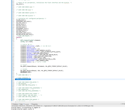

1、When I Start QSPI Work in main function,The QSPI Will always work。QSPI work on CM4-Core。
source:

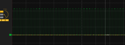

The QSPI CS signal wave,which Delta Time is 13us,not big than 1s according code:

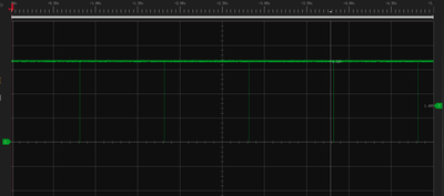

2、When I Start QSPI Work in FreeRTOS Thread,The QSPI-CS signal Always High,and clock is always out 。QSPI work on CM4-Core。
source:
The CS Signal is always High, And clock signal is always output.The next is qspi-clock signal:
My Question is:
1、When I Start QSPI transmit-receive in main() function, It will always work, no stop. It's CS-signal always output low and high. Why?
2、When I Start QSPI transmit-receive in FreeRTOS thread, It does not work, CS-signal is always High, and clock is always output.
