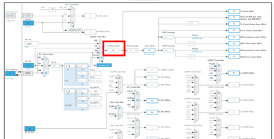

I can see the SysTick_Handler(void) has been generated by CubeMx. Could you please help/explain the following:
- I assume SysTick is the same as (i.e. the period of) the SysClk which in the diagram below (highlighted in red) is currently set to 72MHz, is that correct?
- That SysClk goes (only) to "To Power" and could not find any information as to what that is, so I don't know if changing that value changes other things in my code or generally in the micro configuration. What is that "To Power"?
- how do I set its time period (for example to 1ms) at runtime?
Thank you

2024-08-17 1:54 AM
Your red mark is SYSCLK not systick. In normal HAL code set systick interrupt to every 1ms, not recommend to change is used for timeouts etc. But in handler you can place quick code you require run every 1ms.
For example toggle gpio and create some low speed PWM or blinky ...
For explain SYSTICK is somethink like hw TIM0 capable only create interrupt based on set tick count...
