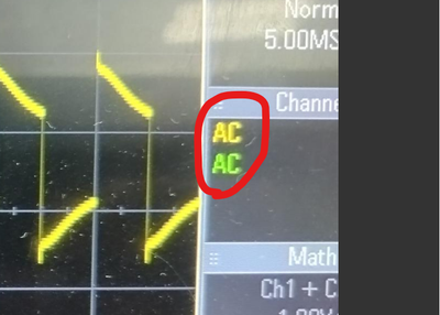

Can you help for resolve the below PWM generation issue,
we are using STM32H7A3ZIT6 controller, in that for the PWM generation configured Advanced Timer 1 with the below configuration and we are getting the PWM wave like below pic. But we need exact square wave PWM.
can you please help to resolve this issue, and can you suggest what kind of parameter we need to configure?

Are you sure your scope probes are properly compensated?
https://resources.pcb.cadence.com/blog/what-is-oscilloscope-probe-compensation
https://www.youtube.com/watch?v=5IqqJVIHmN8
You'll also need to show your schematic - what is the external circuitry on the PWM output pin?
BTW: Your scope must have a screenshot facility - that would give far clearer results than photographs!
2024-01-31 6:19 AM
Your scope settings show the channel is AC coupled. Set it to DC coupled instead.
The PWM signal is most likely just fine.
