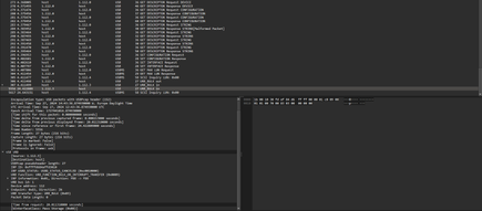

If I look at the USB frames in wireshark I see this:
The first descriptor response string appears to be malformed according to wireshark, but that doesn't seem to bother windows
The real problem seems to be in the SCSI Inquiry: it took the device 20s to reply to the frame number 307 (host -> device URB_BULK in).
