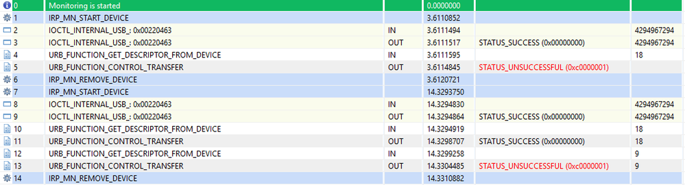

Thanks for the responses. JW, that max packet size fix is only for USB_OTG_HS, I am using FS, the max packet size is already 64 bytes. I got a result from the USB monitor, having difficulty making sense of it. The picture is of two reset cycles on the board. Seems like some exchange is going awry and Windows just disconnects the device. Any thoughts?

Probably the stalling on EP0 bug. Go into the library and comment out any line with USBD_LL_StallEP(pdev, 0x80U); or USBD_LL_StallEP(pdev, 0x00U);. Only for argument 0x80 and 0x00.
https://github.com/STMicroelectronics/STM32CubeH7/issues/22
