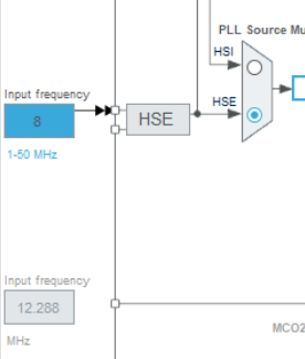

IOC conf:
I see on another post that using the clock from link side could be not the best idea but in f401re there is no external cristal (i am trying to avoid add one if it is possible).
I nottice that filtering the signal with highpass frecuenccy the artifacts are reduce significantly.
One thing that i am not quite sure if it is okey is the clock from de I2S wich has some error (0.26%), but i could not change it to be exactly 44.1khz (i am triying to avoid HSI beacuse i think is worst).

Your Master send to amp require for ok MCLK and no error 44.1 external audio CLK.
Two choices maybe third is use ESP out as clk.
Choice 1 Use audio clock instead 8
Choice 2 External Input freq F401RE??... right freq is on image for 48kHz. For 44,1 use 11,2896MHz
