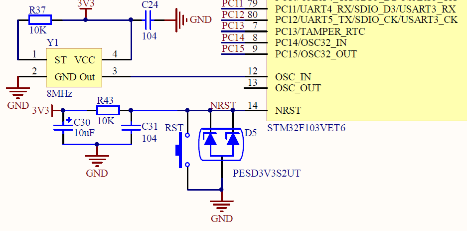

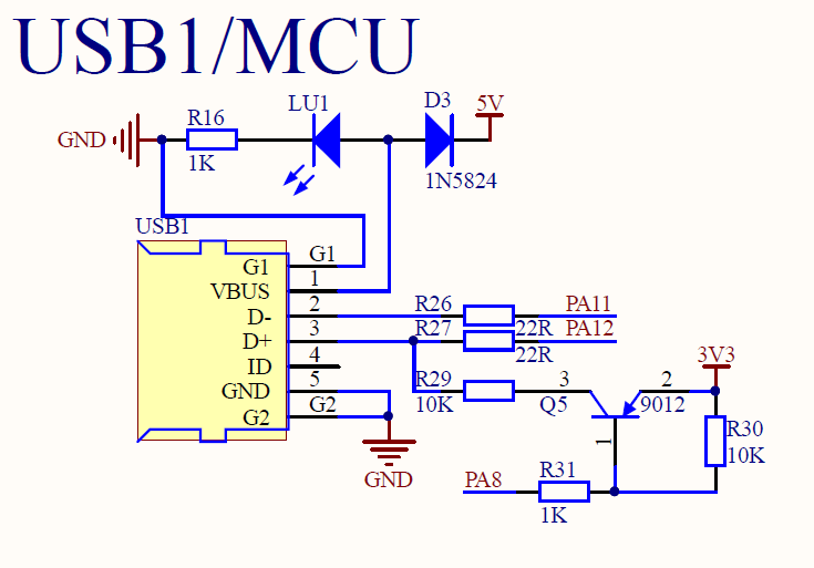

My board is also a custom made board with STM32F103VET6
The USB circuit
The clock circuit

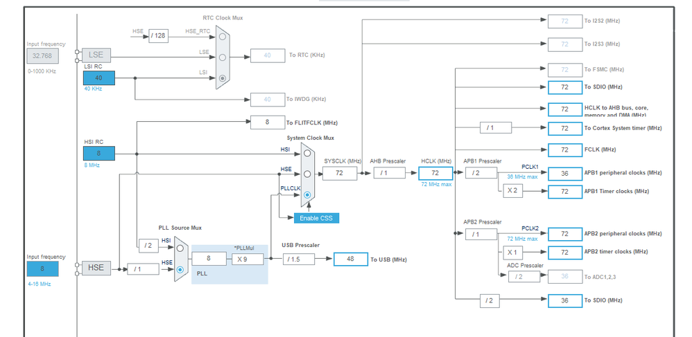

The clock config.
I knew that the demo has no PA8 for pull up, so I added that in "usb_device.c" in "void MX_USB_DEVICE_Init(void)" before "if (USBD_Init(&hUsbDeviceFS, &FS_Desc, DEVICE_FS) != USBD_OK)" but not stable, sometimes (normally nothing happened) I managed to see the flash drive after running the debug mode several time but it gone after 1 or 2 sec.
I will look into the USB_CoreReset() and see what I have found.
Thank you very much again for your help.
Simon

Hi Simon
I am sure I have very inferior STM32 knowledge compared to many here. As far as I can see your clock configuration looks OK to me, for USB FS because you have 48MHz for the USB peripheral which is good. There are TWO things which I can immediately think of which may be causing your problem.

Hi Hans,
Thank you very much your advice.
Eventually I got that work perfectly.
I had changed the value of the resistor and switched on the pull up pin but it didn't work. However, I noticed that when I deleted the customized contents in "STORAGE_Init_FS", "STORAGE_GetCapacity_FS", "STORAGE_Read_FS" and "STORAGE_Write_FS" under "usbd_storage_if.c", my pc could detect the USB drive but it asked me to format the drive, then I understand the drive didn't show up because of the problems of my custom code ! I did some google search again and found one example to the drive perfectly. I can have a good sleep tonight.:D
