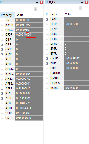

2019-07-21 9:01 PM
Hi JW,
I spent some time on the systemClock_Config of the STM32L053R8.
When the TIMER and USB work at the same time, the problem of the timer counter has been repositioned.
Please take a moment to help analyze;
After SystemClock_Config,The RCC register as follow
If run with breakpoint,the RCC register will modify the configuration correctly. Once run without breakpoint,
RCC register will be cleaned as follow:
Urgently need your help, if you need additional information or need to reproduce this problem, please feel free to contact me.
