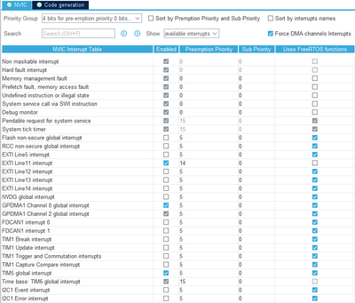

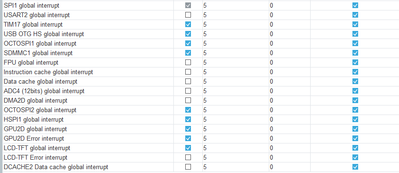

2025-05-30 5:46 AM
@Saket_Om
I have plenty of other peripherals running with enabled interrupts. This is my configuration:
Most of the interrupts have equal priority, so could this be a problem?
What I am doing here is reading data from the SD card, forwarding them to the decoder over SPI, while running a GUI, so there is a lot happening. Do you believe that the issue I am seeing comes from dropping an interrupt on the SPI side?
2025-05-30 6:21 AM - edited 2025-05-30 6:55 AM
Hello @G_Anastasopoulos
To check this hypothesis, you need to try running SPI lonely or make SPI interrupts priorities higher than another peripheral.
You can also check the IT mode instead of DMA mode and check if the issue come from DMA
2025-06-02 11:58 PM
Dear @Saket_Om
Thank you very much for your assistance so far. Unfortunately testing with the IT mode is not going to provide us with any assistance as we specifically need to be using DMA in order to be able to pause and continue.
Based on your suggestions I tried a couple of things:
I tried increasing the priority value of everything else but the GPDMA channel 2 and the SPI global interrupt, without any success. I then tried to decrease the priority value for the EXTI of line 11, which is responsible for pausing and resuming DMA, also without any success.

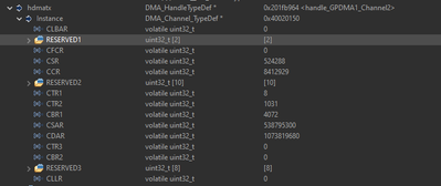

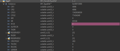

Leaving the device overnight to get stuck, I see this state:
spi interface
and gpdma for the SPI TX
From what I understand by looking at this, the SPI device is not actually doing anything and the GPDMA has 4072 bytes that it needs to send, based on the CBR1 value, is this correct?
What exactly needs to be done at this stage in order to get the DMA going?
Does this state of the 2 peripherals perhaps helps a bit more with understanding what is the issue?
