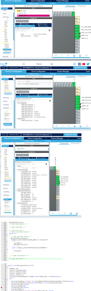

PS the followed is the picture of the cubemx and the code, which is very simple:
