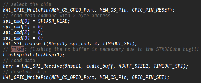

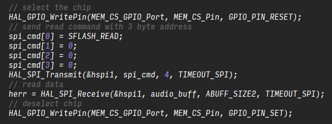

In my senario, a SPI eeprom is connected to a STM32F051, whose SPI module was set to a full duplex master mode. My original code to read a block of data from the eeprom was like this:2016-06-08 6:24 AM

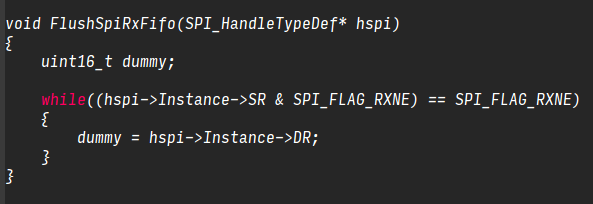

Hi Mayla,
Thanks for the reply. However my understanding is that when SPI is set to full-duplex mode, the RX buffer is always operational regardless of HAL_SPI_Transmit() or HAL_SPI_TransmitReceive() being used.The problem in my case is that the RX buffer was not empty when HAL_SPI_Receive() was called but had un-read garbage data due to previous full-duplex transaction in this case HAL_SPI_Transmit().One obvious solution is not to use HAL_SPI_Transmit() / HAL_SPI_Receive() in full-duplex mode but use HAL_SPI_TransmitReceive() only. But the situation is the same actually since you have to separate your data from the RX buffer whose contents include garbage bytes at the beginning. Thanks,2016-06-08 3:01 PM
