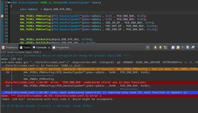

I'm currently working with the classic core MW repository. There is a problem. In the function USBD_LL_Init(), in usbd_conf.c , there are functions that are not compliant to STM32N6 like HAL_PCDEx_PMAConfig. How do I replace them. This is the only error, that I get from the IDE. Also, there are some definitions from the example like PCD_SNG_BUF and CDC_IN_EP that are not defined anywhere. Can you help?

2025-12-08 12:02 AM
hello @bleqy
can you please share with us a caption of the problems window from your CubeIDE to see the full error that you are getting?
Gyessine
About that, STM32N6 unlike the STM32F4 you used to work with is not embedding USB device controller to use Packet Memory Area! The STM32N6 embeds USB OTG controller. So we use FIFOs instead of PMA.
