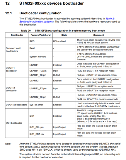

This is from the AN2606 Application note and mentions both pin sets for the STM32F09xxx device bootloader.

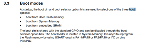

This is from the STM32F091xC data sheet. It only mentions PA14/PA15.
Does anyone have any idea which one is correct? Could you use both pin sets for UART2 to talk to the bootloader? Or only the PA14,PA15 set?

Hello @MFord.1 ,
Both PA2/PA3 & PA14/PA15 can be used for USART2 as on AN2606.
I'm checking the DS and I will forward your feedback internally to update it.

Thank you Imen!
I just wanted to clarify that you mean both PA2/PA3 and PA14/PA15 can be used to activate/talk to the bootloader, correct? I know they can both be used for USART2 in general.
Thank you again.
2021-04-01 6:47 AM
Yes, that's correct.
Imen
