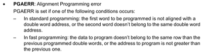

I am trying to use this code to save a 332 byte (83 double word) long data to the STM32L496 flash memory. For some unknown reason, every second time I call the function, I encounter a PGAERR. The third time it works fine, but the fourth time it fails again, and so on.
A double word is a uint64_t, and 332 bytes is 41.5 of them.
