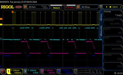

Overall traffic until TRX is gone (red circles mark where same TRX of 4 bytes should be visible):
Zoom in to first 2 bytes (correct behavior):
Zoom in to second transaction (NOK, just first byte is sent):

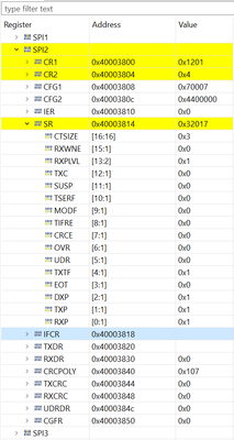

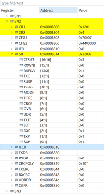

I also include 2 screenshots with state of all SPI2 registers in the moment (breakpoint stop) before HAL_SPI_TransmitReceive() is loading SECOND byte to TXDR for first and second transaction to see the difference. It is just one flag: TXTF which is set on second transaction but not on the first one.
First time:
Second time:

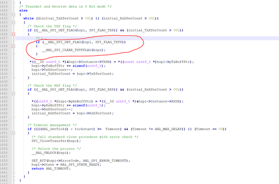

I followed observed difference in SPI transaction 1 and 2 -> TXTF flag. When I clear TXTF flag, see below in red, in HAL_SPI_TransmitReceive() function, then I unlock transmission to go on; it seems working fine, will check more tomorrow. It is ad hoc experiment, more checks needed but at least traffic continues...
And screenshot from the scope :)

It seems that such simple fix helped me to get rid of the problem reported above. Now I concentrate on funcitonality itself of the SW stack behind ST33TP.
Nevertheless, the issue with unhandled TXTF flag, while HAL_SPI_TransmitReceive() is executing, which is blocking further transmission until clearance, is not the expected behavior of SPI driver. If so, shouldn't this issue be taken over by HAL supporting staff to deeper investigation and potential bug fixing?
