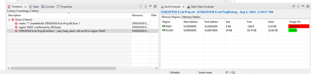

Well, that's the way it is. 8k RAM is too small for using FreeRTOS. You may check the Memory Details tab and fiddle with the FreeRTOS and compiler options, but you will sooner or later hit the memory limit again. 32K RAM maybe okay for first experiments, your mileage may vary.
hth
