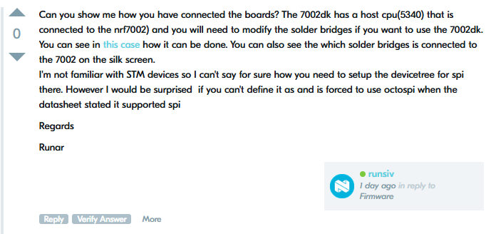

I have already ask with Nordic team. But they are taking time to reply back. And also not helping me to solve the problem. I don't know if they support the other host MCU to get work with nRF7002 via QSPI ?

2026-04-23 6:19 AM - edited 2026-04-23 6:38 AM
Please post a link to that Nordic thread.
EDIT: I guess it's this ?
