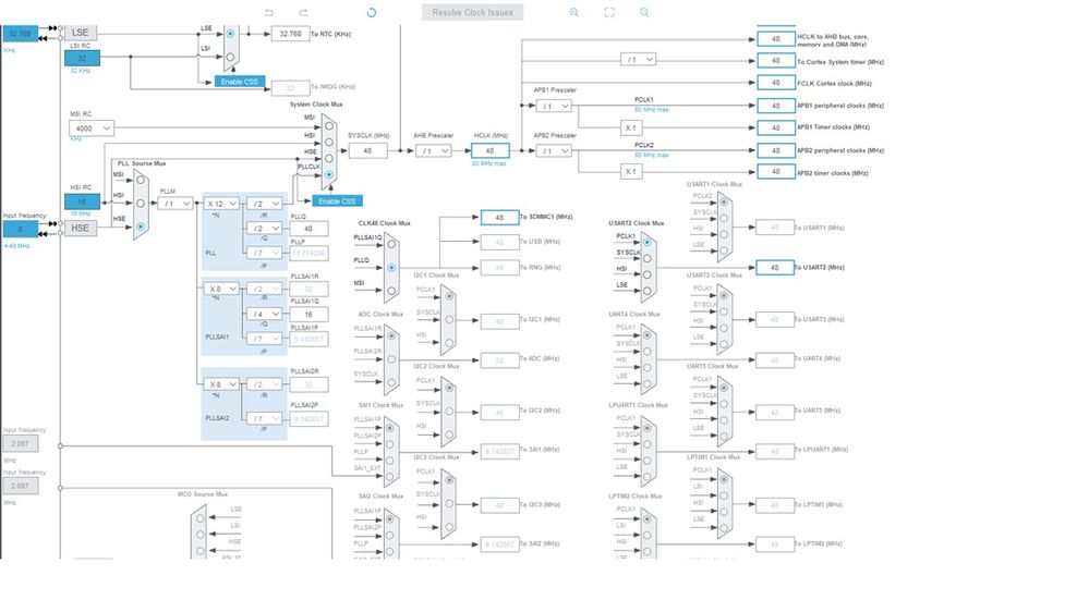

HI, I have STM32L476RG nucleo board. I have interface a SD card using SDMMC. I have configured SDMMC as 4bit mode with TX, RX in DMA mode. I have configured FATFS. I have given 47K pull up to DO to D3 and CMD line. I am using CUbeMX 5.5.0. The FATFS version is R0.12c.

2020-02-03 2:31 AM
I have programmed by nucleo-L476RG board from STM32Cube_FW_L4_V1.15.0 ( provided by STM)
D:\en.stm32cubel4_v1-15-0\STM32Cube_FW_L4_V1.15.0\Projects\STM32L476G-EVAL\Applications\FatFs\FatFs_uSD_Standalone
the f_open function creates the a text file STM32.txt in my SD card. but f_write function return error. SO f_write is not working.
Since I am able to create a STM32.TXT in my SD card, I assume my electrical connections are OK. Also I am getting SDMMC_CK as 24MHZ on the oscilloscope.
(SDMMC_CK = SDMMCCLK / [CLKDIV + 2])
MY SD card is FAT32 format 16GB SDHC.
