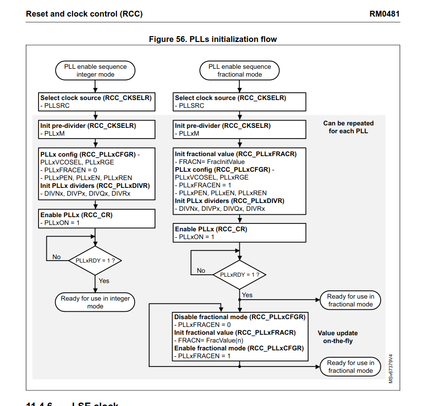

2024-07-02 1:42 AM
The command in line 23 is wrong. The HSE is the source, but the bits are right
2024-07-02 2:06 AM
Why are you enabling the fractional mode, when you program the integer mode (RCC_PLL1DIVR) from the PLL?
rcc.pll1fracr().write(|w| w.pll1fracn().bits(0));
rcc.pll1cfgr().write(|w| w.pll1fracen().set_bit());The initialization flow according the TRM:
