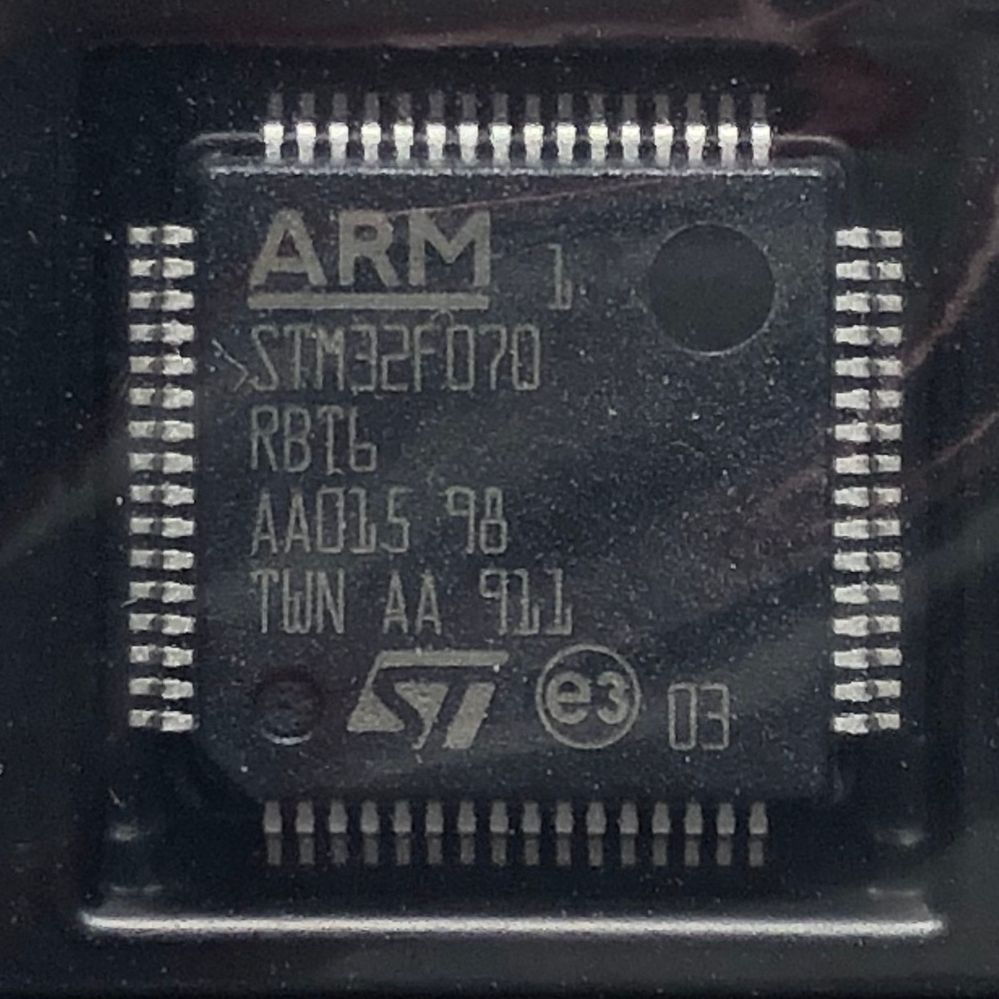

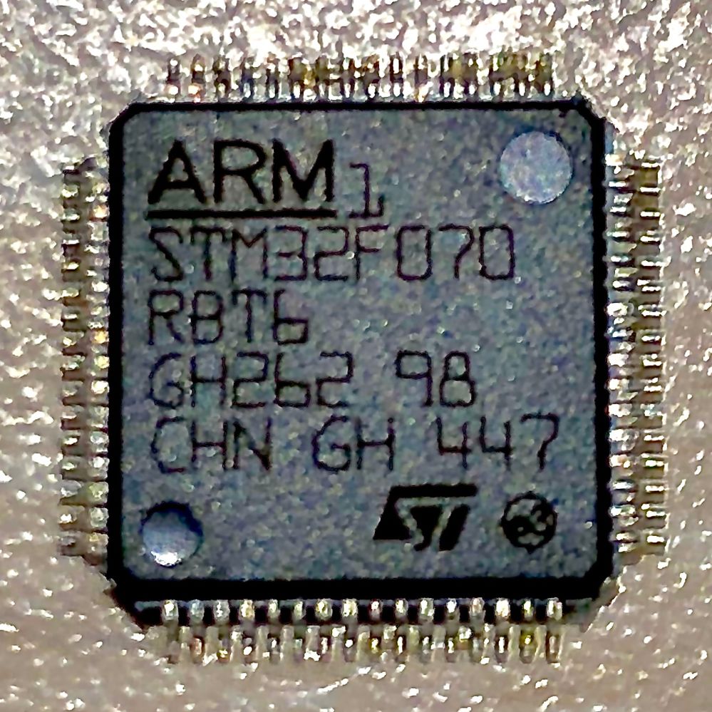

2019-12-04 1:45 AM
Hello @TPryn :
We check the Nucleo-F070RB onboard chip date code is "441" and no reversion code.
"411" is mean 2014 year and 44 week.
And we buy the new STM32F070RB chip date code is "911" is made in this year. The new chip with a reversion code "03"
We replace chip on the Nucleo-F070RB. The bootloader is work.
Maybe the first version bootloader has some problem, but new version is fix.
I think you can check the date code on Nucleo-F070RB first.
Good Luck.
