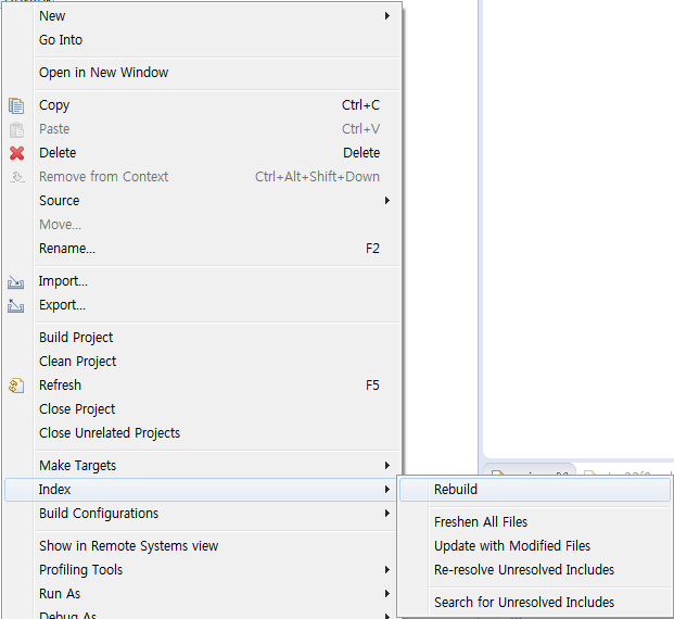

,Could you try to rebuild the project using: 'Right click on the project -> Index -> Rebuild'.
Give me your feedback.
Khouloud.

Hello Mr Khouloud,
Thank you to respond here.
Don't you mean the following way?...
This process does not change anything, CDT build log is empty !
