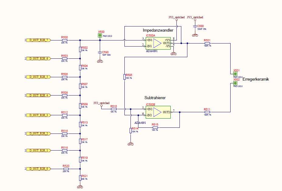

I'm working on a project and could use your help. I'm trying to make a sine wave with a changing frequency from 600 Hz to 5 kHz using STM32 microcontroller(STM32L073RZT) with 32 MHz as sysclk.

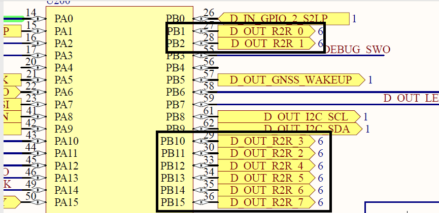

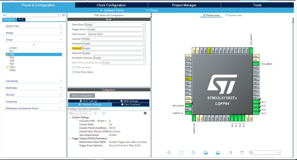

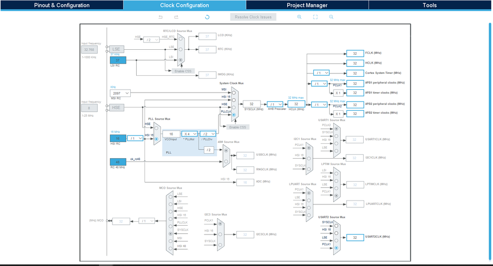

This are my configurations. Where this r2r pins are DAC bits.
I am not able to generate sine wave more than 280 Hz but i want to generate till 2 KHz.

2024-07-05 3:15 AM - edited 2024-07-05 3:16 AM
You dont show schematics, but when not connected same weight bits order on port B change your design ... and learn how to use bare metal registers GPIOB->BRR BSRR ODR ...
2024-07-05 4:11 AM - edited 2024-07-05 4:17 AM
Here is the schematics
