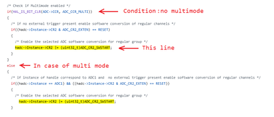

It's considered at this line:
Condition: No ADC multimode configured.
Knowing that in multimode ADC1 is the master.

You are right, I accidentally enabled the multi mode by writing too large a value to CCR->ADCPRE...
