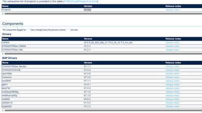

I've seen that, trying to download the STM32CubeH7RS Firmware Package from CubeMX, I'm seeing the latest version is 1.3.0.
On the actual documentation and GitHub repository https://github.com/STMicroelectronics/stm32h7rsxx-hal-driver I'm seeing that the version is 1.2.1
Dates are the same, so I think the version is the same, just with different numbering; is it correct?

Hi @nico23
It's generally a matter of time to update the tag, but you are comparing 2 different repositories. See release note, updates in CubH7RS applies to Projects only.
