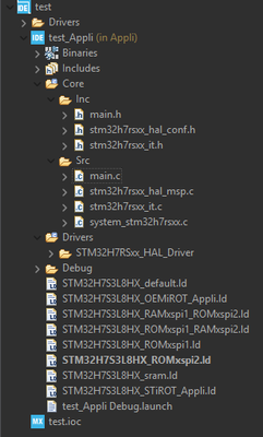

After a fresh IDE reinstall, I can now create Appli-only projects. But, as before, I still see inconsistent code generation in CubeMX for a minimal setup like:
USART3 on PD8 (TX) / PD9 (RX)
GPIO output on PD10 (LED_GREEN)
Issues
SystemClock_Config() is not generated at all (it's only generated in 'BOOT' project).
PD8/PD9 pins config doesn't appear in main. It appears only in HAL_UART_MspInit() (in stm32h7rsxx_hal_msp.c) and not in MX_GPIO_Init()

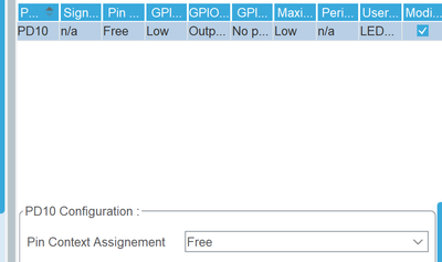

2025-08-12 7:05 PM

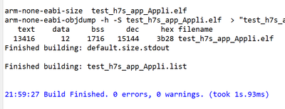

The code generates fine for me and the project compiles.
HAL_UART_MspInit is the correct place to initialize UART pins, and it does so for PD8/PD9.
PD10 is missing a context, so it is not initialized anywhere. If you want the application to initialize it, set context to application.
So remaining complaint about SystemClock_Config. Yeah, seems like that's a bug.
2025-08-12 10:16 PM - edited 2025-08-12 10:57 PM
Thank you! @TDK
"Pin Reservation" for PD10 got it initialized indeed. I still cannot get the SystemClock_Config init although it seems set in Advanced Settings.
