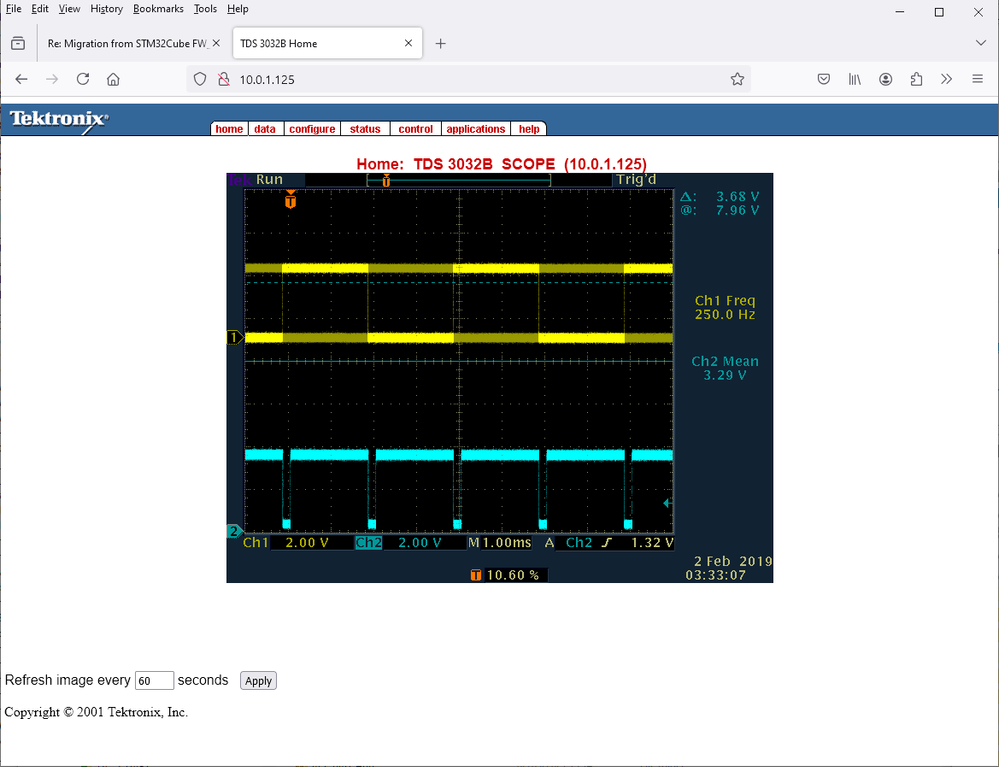

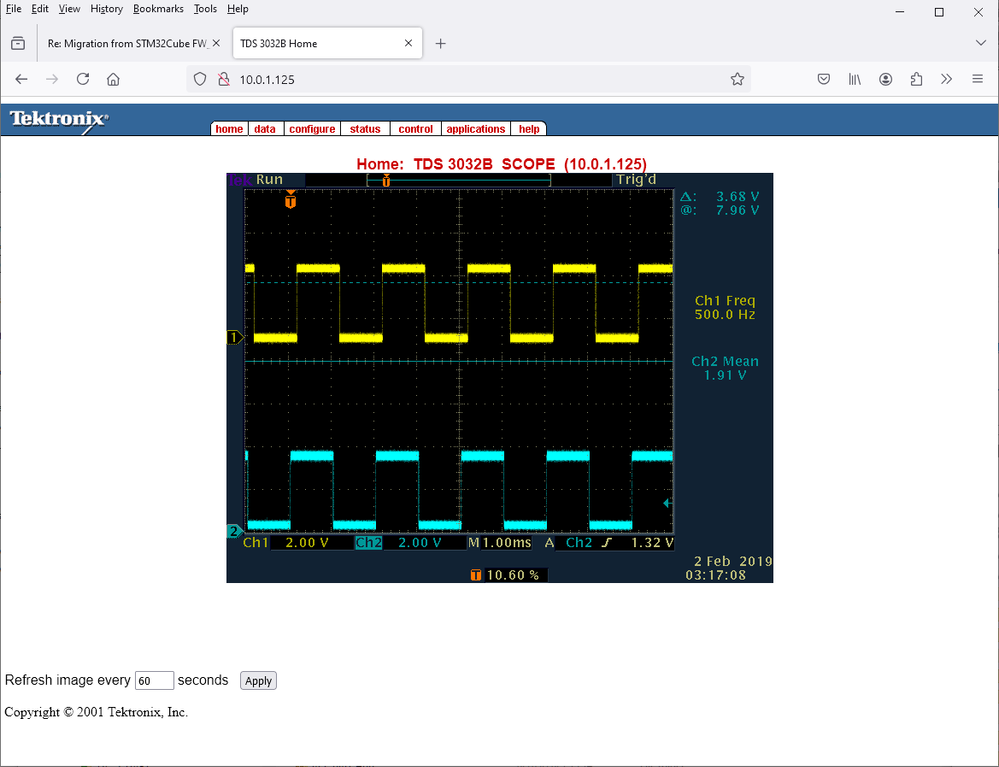

Attached are 2 screen shots of the scope:
Blue curve is the GPIO line that is toggled on each interrupt of the SYS-timer; yellow one corresponds to timer15 sets to a one millisecond period as well.Working
Not Working
When not working, the duty cycle of the sys-timer is different at each run of the MCU, and the behavior of the tiumer15 changes as well: sometimes it gets 1 ms period as expected, sometimes it goes to 2 ms (as it is on the graph)!
it really looks like something is not well initialized somewhere.
