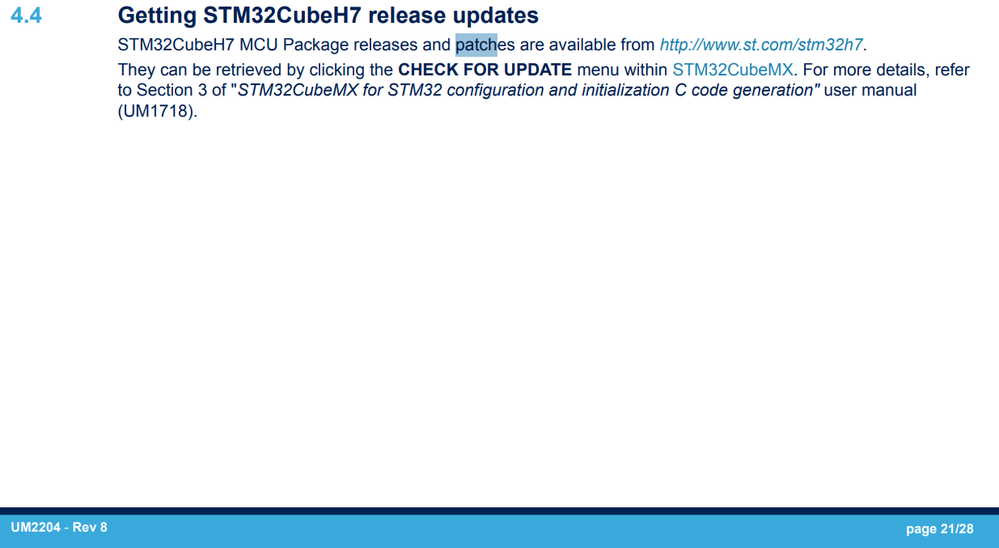

In standard computer terminology, a "Patch" is an update to some existing software - without having to completely replace the whole thing.
For specific details, see UM2204, Getting started with STM32CubeH7 for STM32H7 series MCUs:

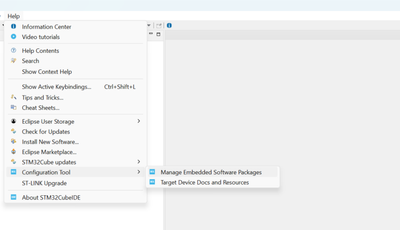

Thank you, can I install firmware patch in STM32CubeIDE with "manage embedded software packages" ?
2025-08-26 7:12 AM
Hello @bsp ,
This functionality is well supported on STM32CubeIDE.
Under [Help] [Configuration Tool], you can manage the Embedded Software Packages.
Thanks.
Mahmoud
