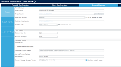

i hope im using latest version of FW pack:

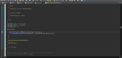

but the lwIP code seems to be different:
where i can update lwIP for latest version? I thought it is part of FW pack for F7 family.
2024-10-24 9:46 AM
Hello @Petr3 ,
you are right, the generated code with MX is generated with the old Ethernetif.c template I'm able to reproduce this and I reported it internally (ticket number 194996 internal reference only) for investigation
in the meanwhile, I suggest you make those changes to your code manually and you should be good to go.
