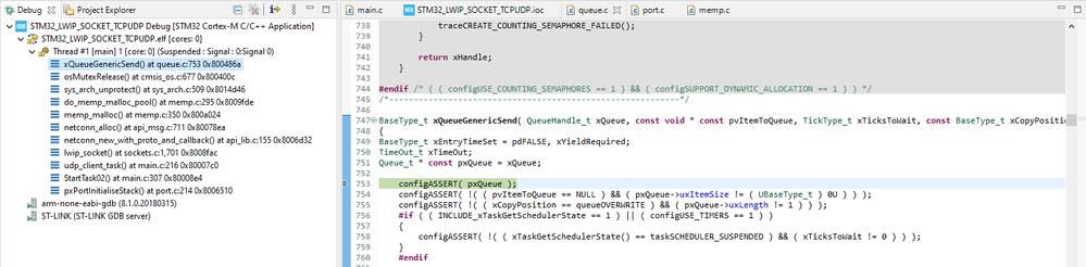

I have two tasks. StartDefaultTask and StartTask02
StartTask02 task called first and ıt stacks in line as shown in the picture below.
StartDefaultTask never called by OS.
I think there is a memory allocation problem
