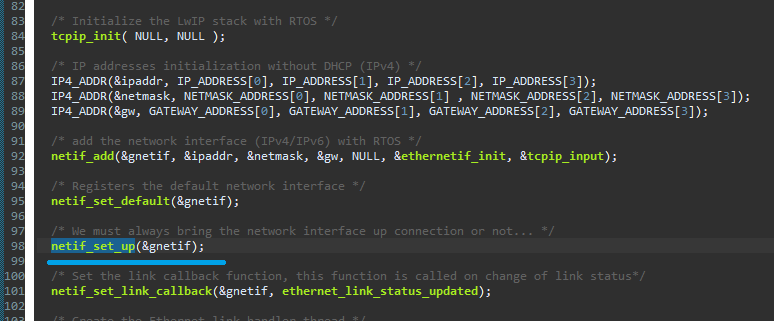

I have created an lwIP + FreeRTOS application using CubeIDE for my Nucleo 439 Board. The problem here is that the the init sequence generated by CubeIDE
LWIP/App/lwip.c function
MX_LWIP_Init()
it calls the following function without checking for the actual status of PHY (even when it is possible)
/* We must always bring the network interface up connection or not... */
netif_set_up(&gnetif);So, even if I don't plug in my LAN cable to the RJ45 of Nucleo board, my network is marked as "UP", while actually its is "DOWN"
I don't understand the need for this. I have seen the the EthLink thread is already testing the status of the actual phy and calling the same function for us. So what is the need to call it in init sequence?

2025-06-20 2:58 AM
waiting until the cable is connected is the purpose of the link monitoring function you mention.
it polls until LAN8742_GetLinkState() returns link connected status. Then it calls netif_set_link_up().
It is all right to have netif_set_up() called before. The LwIP stack will process packets only when netif_set_link_up() is called.
If this doesn't work, then you need to investigate why the LAN8742 doesn't return proper status.
Are you sure everything is configured correctly ?
Is the board connected to an ethernet switch that use auto negotiation ?

Hi
In LwIP, the netif "up" and "down" status is kind of an "administrative" status. It means "LwIP can process the packets" (even if the hardware link is not ready).
What you are looking for is netif_set_link_up(). It is another flag ("link" flag) that indicates if the hardware network link is ready (physically connected).
So you can have a netif that is up (it is allowed to process packets) but with a link down (so no processing of packets until link is up).
Note that both flags don't mean 'please do the action'. They mean 'we have done the needed operations, now LwIP can handle the IP packets'.
see lwIP: Flags NETIF_FLAG_UP, NETIF_FLAG_LINK_UP

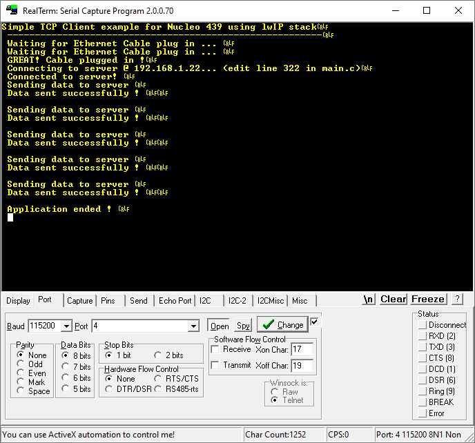

/* USER CODE END 3 */In my application code I wait for cable to be connected before I start any network transactions. Its a while loop that polls this variable that is is_net_up with one sec gaps between polls and as soon as it is set to 1, we break the loop and print that cable has been plugged. After that our code proceed to network IO.
void StartDefaultTask(void *argument)
/* init code for LWIP */
MX_LWIP_Init();
/* USER CODE BEGIN 5 */
printf("Simple TCP Client example for Nucleo 439 using lwIP stack\r\n ");
printf("---------------------------------------------------------\r\n ");
while(is_net_up==0)
printf("Waiting for Ethernet Cable plug in ... \r\n ");
osDelay(1000);
printf("GREAT! Cable plugged in !\r\n ");
}Its the output of the program on Serial Terminal
